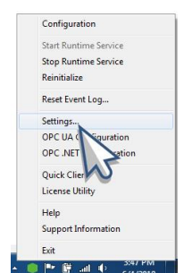

Hello, You can Create a server user group for the specific purpose of using the OPC UA interface and adjust the permissions for that group .
1. Open the User Manager in Settings.
2. Click New Group.
3. Assign permissions to the new group
4. Right-click on the new group.
5. Click Add User.
6. Set a strong password.
Note- The password must be at least 14 characters in length and include a mix of uppercase and lowercase letters, numbers, and special characters.
Here is how you can find the above settings:-
1. Open the Administrative Settings by right-clicking the product icon in the system tray and choosing Settings.
2. Select the User Manager tab.

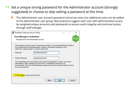

Thanks so much for the quick reply : I wish I could - when I click on the settings tab to adjust user groups it asks for my admin password - this is the issue...
If you don't remember, then you would need to follow the procedure below to reset the password.
I tried this and there was nowhere in the initial setup for the kepware demo to setup an administrative username and password.... Maybe this is a feature that is held back from the demo? I just wanted to have simulated data pushed out to an opc ua class in python, the client later will pay for the software, but for proof of concept - I need to show this data pushing out and into some usd models...
It seems you are on the right track. When prompted to set up an admin/password, you can either create a new one or skip this step by clicking on "Skip Setting" (not recommended)(refer below screenshot).
Once installed, you can use the default provided simulated project for your work. If it doesn't load automatically, you can find it at the following location:
