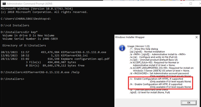

Hi community,
I need to automate a KEPServerEX installation but also want to enable the Configuration API at the same time, so it cannot be forgotten.
Is there a way to specify this in the KEPServerEX6.ini file during installation or is there a way to manipulate the [Config API Service] in the C:\ProgramData\Kepware\KEPServerEX\V6\settings.ini file?
All comments an insights are much appreciated!

Thank you for your reply @VladimirN , but that does not really answer my question. Neither in the KEPServerEX Manual, nor in the KepWare configuration-api.pdf does it mention how to enable the API implicitly during a silent installation or in any other way using a program.
I need to prepare the installation of 40 instances of KEPServerEX, performed by several different people and I want to automate it as much as possible.

Has there been a solution to this yet?
The upgrade process is not very good when it does not retains setting.. pushing updates to 50 servers with silent install and then having to log in and re-enable the configuration API on all 50 servers every time there is a new version is not a great experience.

I came across that by pure chance. Call the KepServerEX installer program from a command line with argument /help and you get this:
Hey presto, Config API enabled during install!
