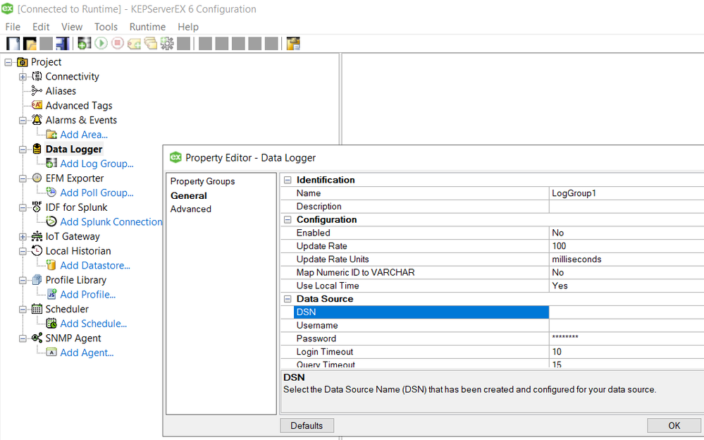

Devang_Singh
(To:AKshara)
Hi Akshara,
Thanks for your reply. From the screenshot below, it looks like we don't have Datalogger configured yet. Do we need to this first? Secondly if its not configured yet, does that mean the duplicate issue is coming from somewhere else?
AKshara
(To:Devang_Singh)
Thank you for adding details; however, it is hard for me to imagine where you have been seeing the duplicate entries as there is no DataLogger configured.
Is there a third-party logger installed?
Certainly, I have developed an interest in analyzing the situation in depth, and it would be highly appreciated if you would log a case using My.Kepware for further analysis.
Don't forget to attach a copy of the project. A basic application report will also add value. Please follow the steps mentioned in the manual to generate a basic application report.
-Akshara

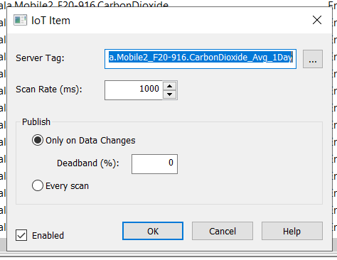

Devang_Singh
(To:AKshara)
Yes. Actually we have an ADX integration which let us know about the data coming in. Running the query on it is how we got to know that there is multiple instances of duplicate data running into millions. Before we had 'every scan' selected and started receiving data every sec for every item across all our devices. We started receiving too much data then since ADX was not equipped to handle this much data. We changed this now to publish only when change occurs but there is still duplicate data coming in (with same telemetry value against same timestamp) thats why wanted to know if this is something that can be avoided.
