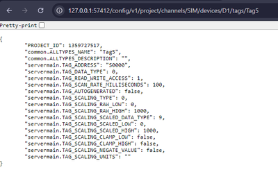

Hello Team,
I would like to read the value from configuration API service, How can read the Value?
rajskumar
(To:BRangi)
The Config API is used to perform Kepserver configuration from remote machines. It can’t be used to read the value of a tag. You need to use the REST server of the IoT gateway, and then you can read the value using any REST client.

Thank you @rajskumar .
