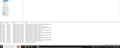

I’m sending MQTT data from Kepware IoT Gateway to ThingsBoard. Everything works fine when I publish around 250 tags in a single JSON payload. But when I increase it to 500 tags, the MQTT client in Kepware starts connecting and disconnecting repeatedly, and the message never publishes.
I’m trying to figure out whether this limitation is coming from:
Kepware IoT Gateway’s MQTT Client Agent, or
ThingsBoard’s MQTT broker / MQTT transport,
or simply an MQTT payload size limit on either side.
What I’m seeing:
~250 tags → OK
~500 tags → Kepware repeatedly connects/disconnects
No clear error in Kepware UI
ThingsBoard logs show only connect/disconnect
Behavior suggests a payload or packet size limit

AKshara
(To:AKshara)
As I can see in the event log shot the error : "MQTT agent 'DEV_003' disconnected - reason 'null'
I would suggest going through CS378797 for more details of the error message.
Hi AKshara.
Thanks for your response,
Previously the Max Event Published was set to 1000 due to which it was failing and when i changed it to 100 i am reciving all tags on broker end.
