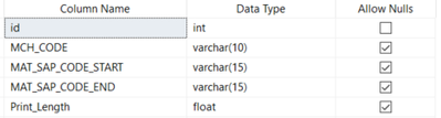

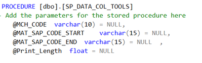

i need to log data that trying to send to stored procedure that may case of issue

You have to check the datatype of both and ensure they match. The SQL logs might give you some idea, not sure about that. though as it may have been checked before even attempting to send to the SQL DB.
At some point KW added a field to their standard table creation so if you aren't populating all the fields you could get this error.
Post your fields in KW and the ones in SQL
CAST means that you are trying to change one datatype into another datatype. So the datatype of a value you are trying to log doesn't match the datatype of the database field that you are trying to insert it into.
okay, how can I check data before send to Stored Procedure to avoid any issue later?
so, what is the deferent, SP and data in Keepware
What about the layout of the table that holds the data? I may be mistaken but I thought this error message came from Kepware ?
that is table "id" is increment
Consider renaming the existing table in SQL server and having KW create a new table from that logging configuration and see if there is a different table configuration created.
