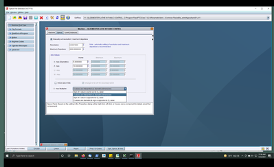

This is actually a post-processor issue like the one answered by KenFarley about your I,K R issue. The instructions are much the same, with the attached picture showing the relevant portion of the post-processor app.
I am using CAMPOST ICAM Version 18.0, where I don't have such options offered from post processer!
