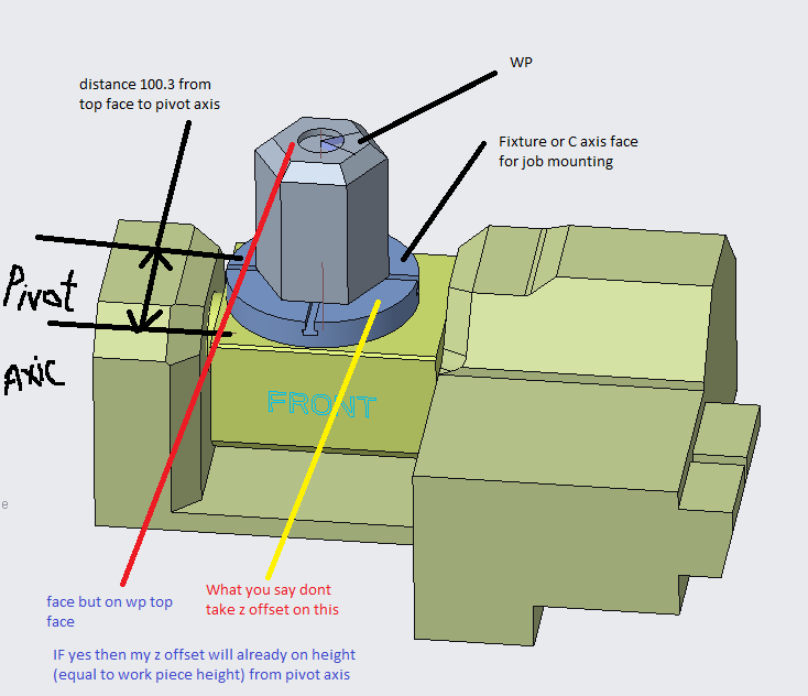

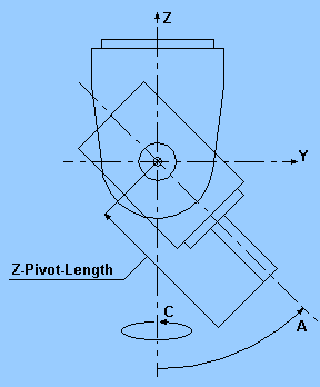

I am asif from Karachi, Pakistan i have a question about the Creo post processor. How to add Pivot distance in dual rotary table 5-axis machine with PTC Creo. and  Swivel-Type (Head-Head) 5-Axis CNC in creo post processor. Please check the pic of the machine configuration. i want to update the post processor for both machines. Please guide.

It seems that many people are reluctant to use Creo NC, and the lack of engagement indicates its limited value in the CAM manufacturing software market. Even PTC engineers seem disinterested in addressing manufacturing-related issues concerning Creo, which is telling about the community's overall response. Anyway, I make it simpler what I need. The issue is related to G43 and G43.4 output
What I want from my current PP the G43 output is fine for 3 axis, and also its placement on the right place
(N15 T1 M06
N16 S2387 M03
N17 G0 G43 Z039.343 H1
But for 4 and 5 axis, I need G43.4 instead of G43, and its placement always needs to be before rotary movement. Check the content for fil file
