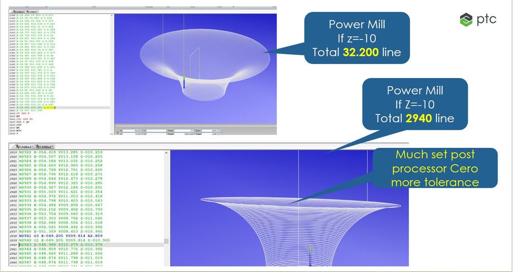

see these videos both videos shown surface machining on same surface one is from power mill other is from creo parametric...in creo machining there is some motion pause during one patch to other patch of surface ..but in power mill no pause continue machining ..why this is happening...is it software capabilities issue or i am some thing missing..please advise..

Hi
please please check post form powermill if z=-10 total lengh =32.200 lines, in Creo NC z=-10 total lengh =2.940 lines that meaning post in PowerMill tolerance more 10 time compare with Creo NC.
Your problem is using default post in Creo, you should edit post processor in Creo more tolerance

i already increase the tolerance but no change also insert this command for look ahead option enabled but no change ...some one say me that change your software ...power mill more advance  software compare to creo ..but my heart is not accepting this .

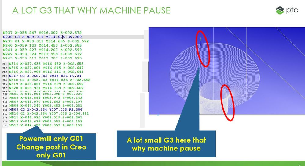

bnguyen-2
(To:asifcad)
Dear
I had fond a Problem that many small arc G3 in Creo NC code that why machine pause at that position
In Powermill NC code only G1 dont have G3
***for some case 3D ARC dont export nc code G2 G3 set in Creo only G1 or you make post processor G01 only
Open you  Creo NC , Powermill nc code in Cimco edit you will see
For Technical you must to check it, can not said that software...

slolli
(To:asifcad)
I took a quick look and just a few things to consider:
  1. Your tolerance in the toolpath is .0001 while your model accuracy is approximately .0018. You never really want tolerance in a sequence tighter than accuracy on the model.
  2. I wonder if your post processor is setup to handle the parameter HELICAL_CIRC_INTERPOLATION a different way than the post that is handling powermill.  Yours is set to HELICAL_CIRC_INTERPOLATION = POINTS_ONLY so it is spitting out tons of GOTO moves, will your post handle ARC moves?

Not sure if anyone is still reading this thread 7 months later or not.  Oh, well.
I think the Powermill code outperforms the Creo code because of one line: G05.1 Q1.
It's towards the beginning of the Powermill code you shared.  What it basically does (to the best of my understanding) is this:
(Begin program - do all the G28/G17/G54 setup stuff)
G05.1 Q1
(Put the high-speed roughing code here)
G05.1 Q0
Basically, what your machine does when in G05.1 Q0 mode (which, I presume, would be the machine's default)
is:
1. Read line of code (G01 X-1. Y-1. Z1.)
2. Interpret -> GOTO X-1, Y-1, Z+1
3. Do the thing -> move the table
4. Check -> Am I at X-1, Y-1, Z+1?
5. Read next code
...and so on
Unfortunately, when you're trying to do "fast" stuff (ie, rough out a cavity), this method results in a jerky start-stop motion.
If you insert "G05.1 Q1" before the roughing cycle, the machine does:
1. Read code (G01 X-1. Y-1. Z1.)
4. Read next code
In essence, the machine is speeding up the machining process by not constantly checking each and every position, or by not stopping after each move.  Different controls have different codes for controlling this motion (and different means of control - some change the gain in the servo drives, some change the "look ahead" (how many lines ahead of the current line the control reads to predict motion), some just turn off the "stop" effect after a motion).
Note: depending on your machine, you need to put the machine back in G05.1 Q0 mode before doing a canned cycle (drill, tap, etc.).
To insert the necessary code, you can:
1. (Easy but slightly inconvenient way) Just type it in.  Before you export each program to the machine, open your program in a basic text editor (e.g., Notepad) and insert the G05.1 Q1 line before your roughing sequences and G05.1 Q0 after them.  Save the file and post to the machine.  If you're handy with the machine control, you can also probably edit the file at the machine.
2. (Harder but more user-friendly way) Edit your post.  In your mfg assemby, select your workcenter and edit definition.  Look for the ID number of the post processor (for some reason, the workcenter in the file you shared has an ID of 1, but the none of the posts you shared are #1.  I think they are 12, 13, and 17).  Anyway, find the post your workcell is using (or should be using - and change the workcell to match!).  You can read the AustinNC documentation that came with Creo's post-processor (GPost).  Those documents will get you started in editing the post to get it to do what you want.
I hope this helps 😃
PS - I think the "R10" on that G05.1 Q1 line has something to do with the "fineness" of the high-speed control, but I'm not sure how it works.  Good luck!
