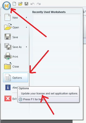

I think you don't need to update the license server. You just need to point to the new license file from within Prime:
HI thank you but its a floating network licence that is used by a number of users and we have the 1 licence, would that work in this case as there is a FlexNet  on our licence server.
BenLoosli
(To:SB_10014675)
if your licenses are on a FlexNet server, you will need to update the license file on the FlexNet server. Normally that is done by IT or your system admin.
Once they have the new license installed, MathCAD should pick it up the next time you start it.
