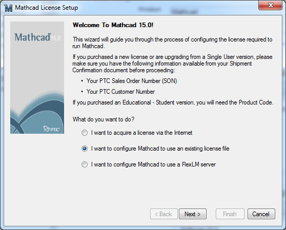

@JM_9827292,
  1. Save the newly received license file on your system, any location (for example: C:\temp)
  2. Then, go to Mathcad 15.0 installation directory (Default Location: C:\Program Files(x86)\Mathcad\Mathcad 15)
  3. Open mclicense folder, then locate and launch mclicense.exe, this would bring up Mathcad License Setup window
  4. Select “I want to configure Mathcad to use an existing license file” and click Next

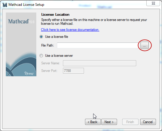

6. Select “Use a license file” and click on the circled button shown below
User-added image
7. In the Open dialogue box browse and select the saved license file and then click on open (Note: change the file type to All files, if required)
8. Click on Next > Finish
