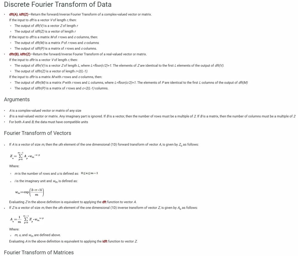

I need to do the Fourier transform calculations.
From the help files:
