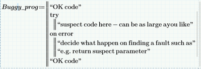

2) The "try" command is helpful in bracketing a region of code where the bug may reside:
3) A bug in a program causes all the data to be lost. The "try" command is handy if you are running an iterative program and generating a lot of data for which you might have to wait a long time (days maybe). It allows you to harvest what has been generated via a return command if a bug occurs in the bracketed region. The downside is that the Error Tracing function won't reveal where the error is.
