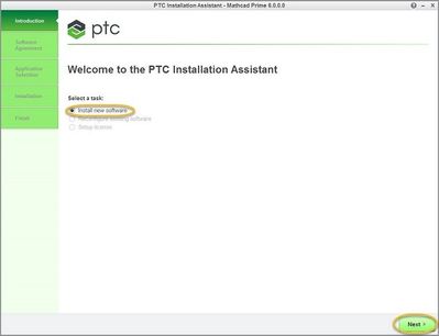

Select #Install New Software and  select #NextSelect #Install New Software and select #Next
1. Select #Install New Software and  click on #Next

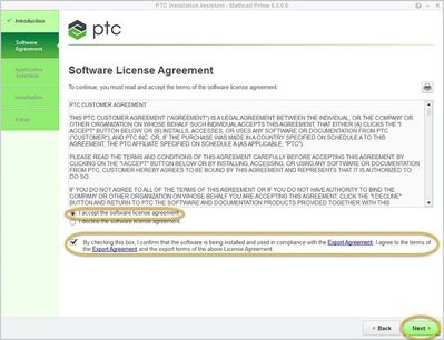

2. Select #I accept the license agreement and Check the box for Export agreement then click #Next

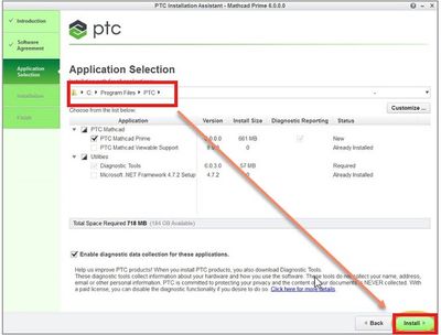

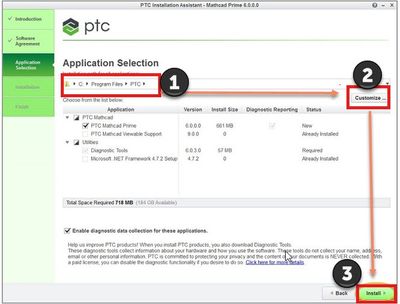

3.  In the Application Selection screen, Change the installation directory, if required. Else, Prime 6.0 will get installed in the default location shown
  • Use option #Customize to change the help center language or to install help center in multiple languages and to set locations for shortcuts for Prime 6.0
  • Choose list of applications need to be installed. By default, all the applications are checked
    • PTC Mathcad Viewable Support is required when using Windchill integration, users who do not use Windchill integration may uncheck this component
    • To get more information on each of the listed application/utilities and customize, refer to page 20 of Prime 6.0 Installation Guide
4. Click #Install to start the installation
