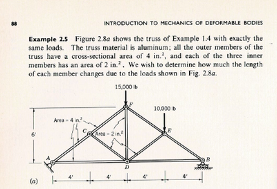

Plane Truss Mechanics
Can you use Mathcad to solve this problem?
This comes from page 88 of “An Introduction to the Mechanics of Solids,” by Stephen H. Crandall, Norman C. Dahl, and Thomas J. Lardner. This was the text for the first mechanical engineering class (2.01 Mechanics) that I took my sophomore year at MIT way back in 1989. You can find the book for as little as $5 on Amazon. It shows three different solutions for the problem, including:
  • closed-form solutions involving equilibrium of forces and the beam-deflection equation
  • a computer program called IBM STRESS
  • Castigliano’s theorem which solves via elastic energy.
Any introductory mechanics text or a Schaum’s Outline should guide you to a solution. As with the other contests that will follow this one, the point is not the answer to the problem, but your execution of the solution.

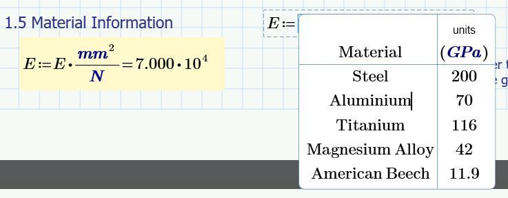

  • Allowing the user to change the material via a Combo Box Input Controls.

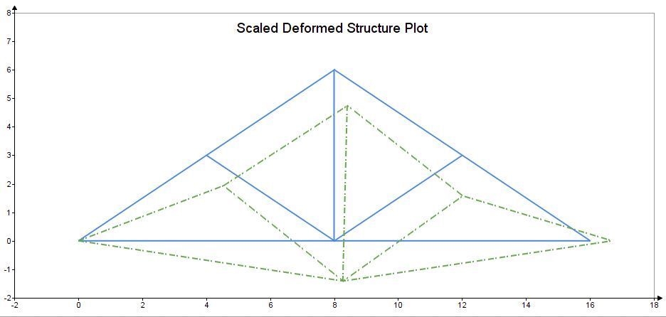

  • Depicting the results with a Chart Component, such as the truss in the deformed shape, or the deflection at D due to changing input loads.

You can also add a selection list ("Combo Box") of different materials (with the corresponding modulus of elasticity) to your calculation: steel, titanium, aluminum, magnesium alloy, wood. Thus making your program more versatile.
Hi Vladimir
Done on my sheet.
Not sure if it worth resubmitting the file with the combo box
Cheers
Terry

Here is another solution to the truss problem. The objective of this solution is to provide a teaching tool to be used in a statics of strength of material course at the sophomore level.
Hi.
Interesting.
The same force in the members is arrived at in each approach.
The downwards deflection of the middle point D is different in each approach?
0.163" by stiffness method 0.05" by virtual work?
I have looked closely and the E used in virtual work method is Steel, and in stiffness method Aluminum.
Cheers
Terry Hendicott
Terry
Thanks for picking this up.  I changed E to aluminum and got an answer of 0.165 inches.
Regards, Dennis Fallon
