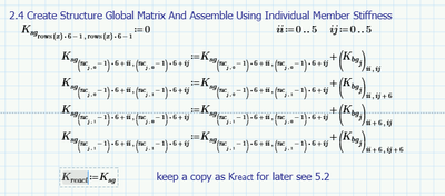

Dear All
Please help for calculating  Transformation of the nodal coordinates of the space
frame element, I stuck here both theory and Mathcad Prime.
I attached file of Mathcad prime sheet and lesson and example.
Best regards
SPRStructur

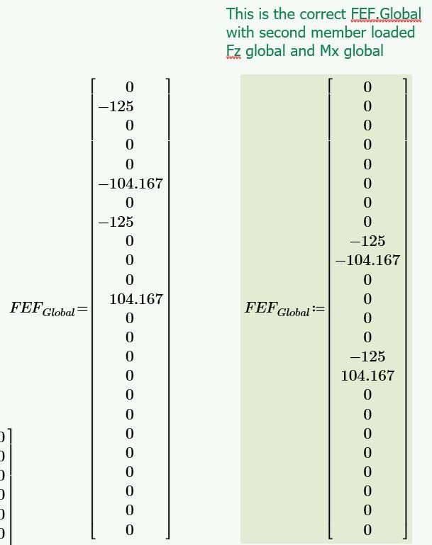

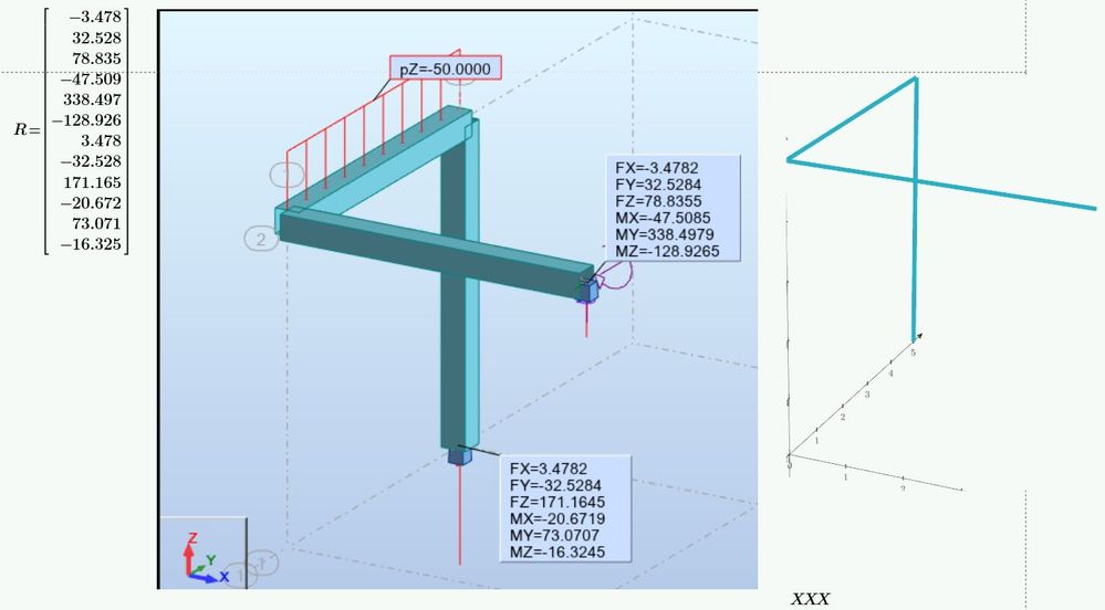

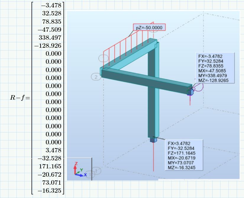

This has taken some work.  To find the error I have implemented another approach to check all the matrices.
Your file "220208-Check Model6" is corrected and gets the right answer.  My changes have been highlighted in green.  View in Draft mode to see them all.
The main problem is the application of the equivalent global node loads from the uniform distributed load.
It seems to place them on the first not middle span.  I have only corrected the global load, you will need to determine why the input does not get correct values.
Correct answer is determined
I have included my file that I used to check all the matrices.

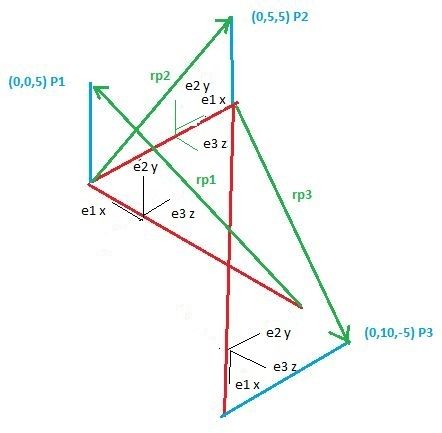

Sent you the wrong local axis.  Here in the terminology of the vector multiplications e1, e2, e3
Corrected graphics below.
Cheers
Terry
Wrong only Picture only right? Algorithm is correct? terry
The algorithm is correct only the graphic was wrong.
Cheers
