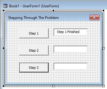

Never had this problem but clearly it exists.  Thought hard about how I would handle it.
One suggestion would be to break up the process into a number of subroutines.
Use Public variables in the Declarations section that can be shared between subroutines.
Create a form with a command button and associated textbox for each step(subroutine).
The last statement in each subroutine is to put text into the relevant text box that the step is finished.
In this way you are using the existing event manager loop of the form to synchronize the bits of the full process.
