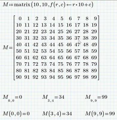

Assume I have a vector of 10*10. How to access one element from the vector in MATHCAD Prime.
Say I would like to know 3*4th element in the vector. How to get the same

You use the vector/matrix index to do so (keyboard short is "[" without the quotes), separating row and column index by a comma.
Note that by default Prime starts to number vectors and matrices starting with 0. You can change this by setting a different value for the system variable ORIGIN (either at the top of the page or via the menu).
So if you have a 10 x 10 matrix, the top left element has the indices 0,0
In Prime instead of using the matrix index you may also use the matrix like a function, providing row and column index as arguments.
Here is an example:

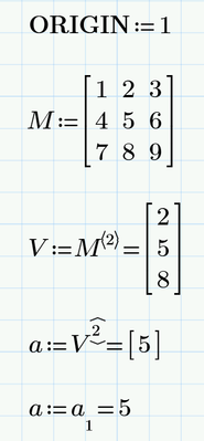

We can do it so too
Who can show an even more exotic way to access one element from the matrix?
Matrix Exercises
How crazy can it get?
