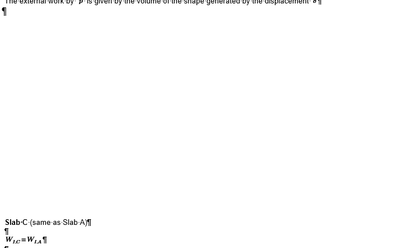

I just tried the RTF and for some reason it creates some page breaks at weird locations, and when I try to delete them, this happens:
a huge blank space I cannot delete
any advice on how to fix this? thanks
if there is a way to get rid of these page breaks, this solution can actually be good
the issue I have now is that for some reason I have some spots with page breaks resulting in One or Two blank pages, and when i try to delete the page breaks, a lot of stuff moves around.

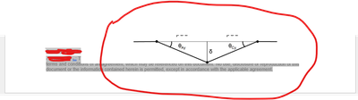

1. text with font size 8-9 are displayed in a size way too small. I can stretch the figures but I would to do so manually, one by one
2. figures that are placed beside a text box goes to a weird location, sometimes even pictures that are perfectly underneath and above text boxes, goes to the next page, to an unexpected spot
3. sometimes there is still a large blank space where there is apparently nothing in the mathcad file to explain it
