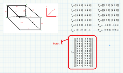

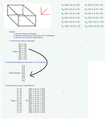

Dear all
please help me  to solve as below:
1- Short the Matrices Automatic (As Picture below)
2- Automatic Numbering of Joint base on E Coordination (As Picture below)
3- And then put (2) into to Initial Matrices (As Picture below)
Best regards

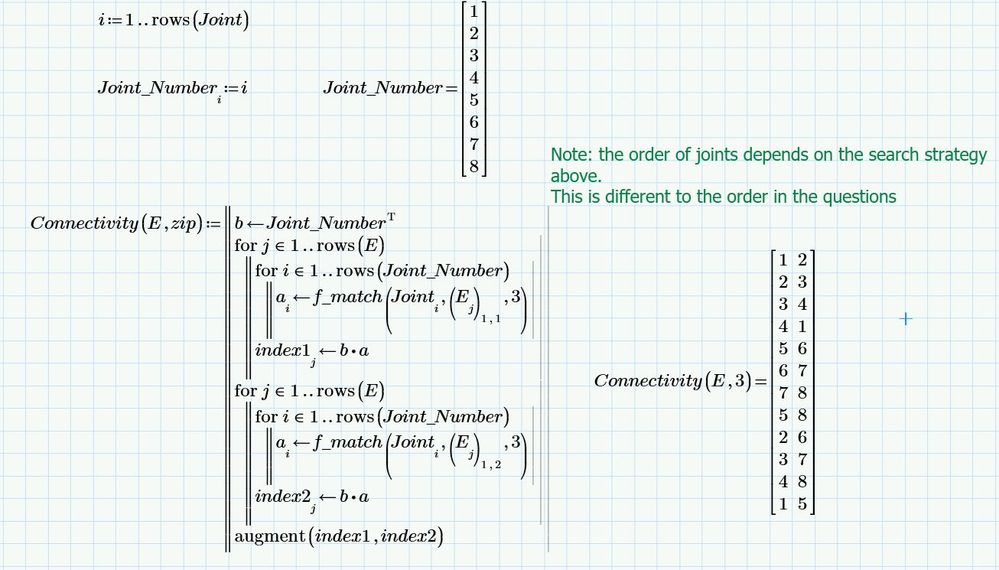

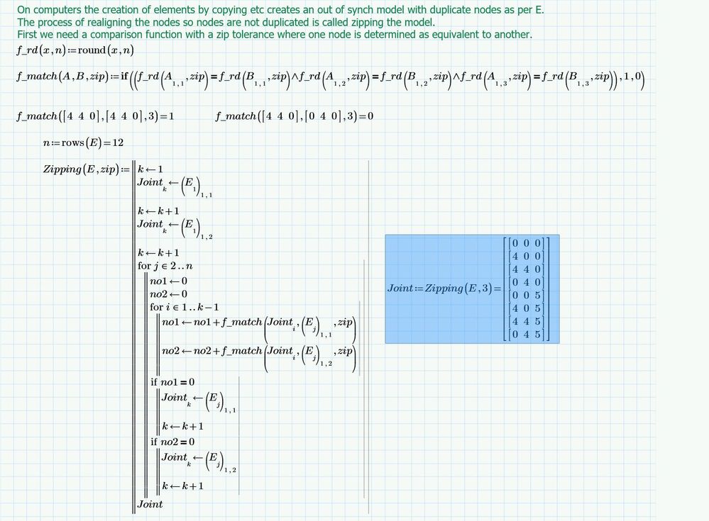

Questions 2 and 3 answered.
Have corrected the use of 3 instead of zip in definition of connectivity in enclosed file.

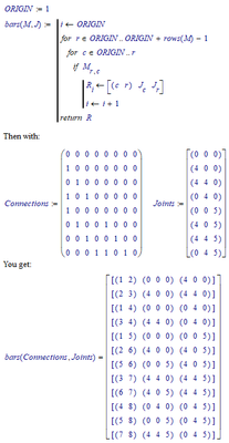

LucMeekes
(To:SPRstructur)
How about:

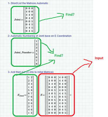

Dear @LucMeekes and thank you but
The Variables are Joint(green ) and E_joint(green) are to Find/Solve
E is the input.
Have done the question 1 obtaining the unique nodes of the problem will work on question 2 and 3 now.
@terryhendicott  Thank u. he works well.
