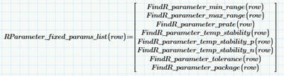

There are 2 Matrices defined as below:
I want to create a function with these 2 matrices as input, to compare the values of 1 matrix to the other.
How can i do this?
I tried doing it like below, But it seems that a function depending on another variable (pnumber or row in this case) cannot be given as an input to another function.
IsParamMatch(RBoM_fixed_params_list(pnumber),RParameter_fixed_params_list(row))

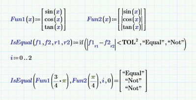

Here's a small example:

Hello!
What is "IsEqual"?
Best regards,
Sergey
LucMeekes
(To:Sergey)
The name of the function I defined just below the definition of Fun1 and Fun2.
Sergey
(To:LucMeekes)
Yes, of course, I had to see it.
