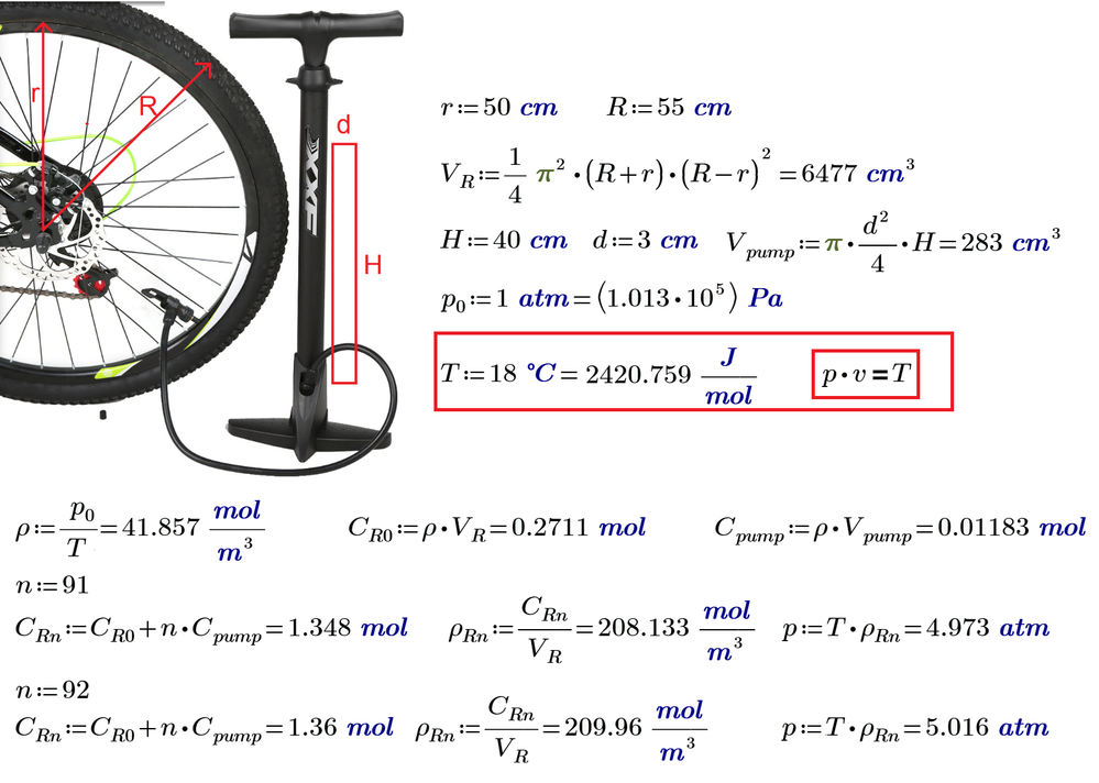

We need the Gravity constant!
We need not the molar gas constant. We must use it only by temperature converting from J/mole to K, C, F, R.
See one calculation
