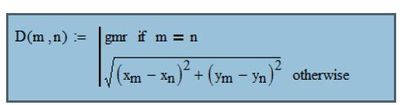

How do you enter the equation below in mathcad prime 4.0

The function is a bit awkward. What is gmr ?
Who are x and y?

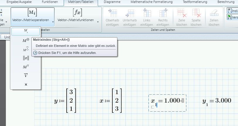

You can do it this way:
Call up the Matrix-index (Depends on the ORIGIN Variable which is in "calculations" defined)
Volker

so gmr is a number = 0.0171
what i am trying to do is this but in the prime edition, i am new to mathcadCapture.JPG

The simplest way to enter x sub m is by typing:
x [ m
Unless you happen to have the German language version of Prime where (according to Volker's picture) you'd have to type:
x <Ctl-Alt-[> m
where <Ctl-Alt-[> is pressing down the Ctrl key and the Alt key simultaneously and while they are down you hit the [ key once. Seems pretty much too cumbersome to me for such an often-used feature!
