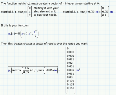

Like this?
Prime 4 file attached.

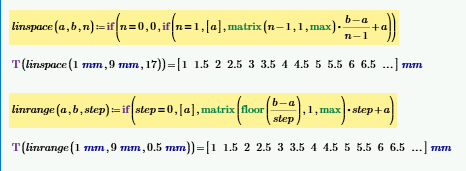

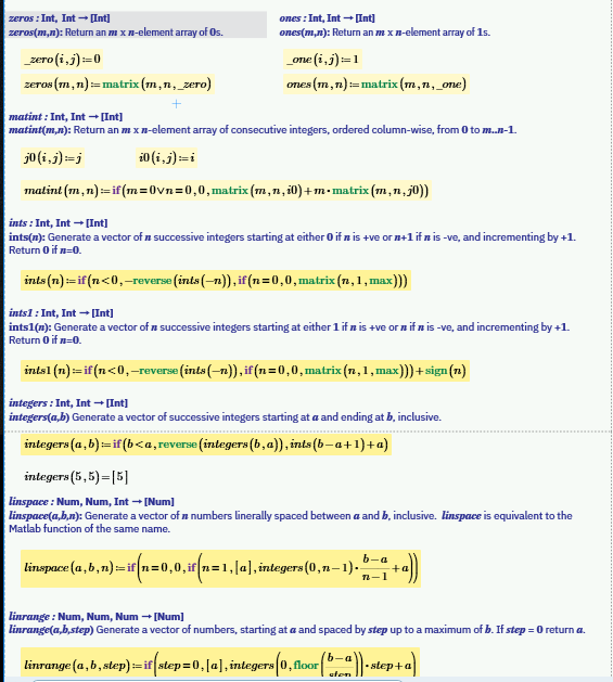

Such capability is so useful that I've got a set of related functions in my Default Template.
The nice thing about using your matrix(n,1,max) is that it's so simple even I can remember it,  It's simple to make linspace and linrange stand-alone using this expression.
Stuart
T is just a transpose function that makes it easier to deal with expressions that may give either an array or a scalar result.  It also helps make nested vector results more compact.
