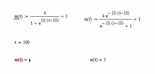

Having issues programming an Euler's method for ODEs. Can't get past error in magnitude of numbers.

You an improve the situation with m(t) by multiplying numerator and denominator by exp(-10(t-10)).  For example:

It's the exponential in your m(t) expression blowing up.

Right thanks, I know the exp function was going to infinity and mathcad won't handle it. In that same mathcad sheet over off to the right in the worksheet I have another disabled program where I tried to address that issue with an if/else statement. I know the exp blows up around iteration 10 so for k<10 I wanted to calculate m(t) and k>10 just print the 'ms' value.

Thank you! I now have a more streamlined program that is at least plotting but the curves just settle around iteration 11. The graphs should look like the image attached. It that program I had a constant value for 'm' but now I want to do one that varies as a function of time.
