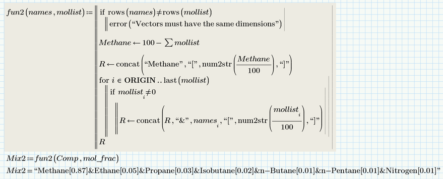

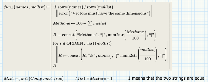

Here is a function which creates the string, including zero values
Here is a slight modification so that zero values are omitted
And here is a function which can do both, depending on its third argument
Attached file is in format P9. Maybe someone ( @LucMeekes  ?) can convert it to P8 format or lower.
EDIT: There were copy & paste errors in the first version of the functions. Is now fixed.
