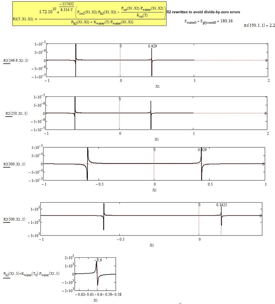

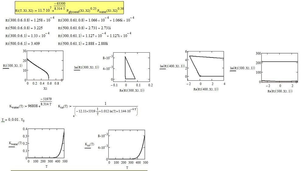

By keeping X2 = 1 and T = const, as X1 varies between -1 and 1, the function R2 has discontinuities:
Thank you for such a detailed analysis it seems at some point we are getting errors due to the discontinuities in R2 and since X1 goes to -1. Maybe finding areas that works for solution can be a better approach. In anyway thanks a lot for taking your time on my problem, I really appreciate it 🙂
