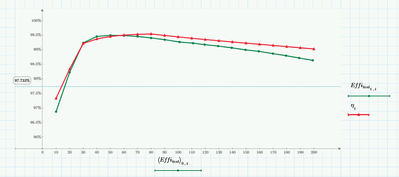

Hi, attached is my calculation file for a set of fixed variables, such as switching frequency fs=15kHz and inductance Lpri=35uH.
And the final efficiency curve is showed in the second last section. Attached is the efficiency curve, but I can do one more step calculation. I can use only one value to represent the final optimization target, efficiency index.
For example, CEC Efficiency = 0.04 x Eff10% + 0.05 x Eff20% + 0.12 x Eff30% + 0.21 x Eff50% + 0.53 x Eff75%. (California Energy Commission (CEC) has proposed another weighting, which is now specified for some inverters used in the US.)
What I want to achieve is that I can vary the switching frequency into a specific range, such as 15kHz to 100kHz, and also specify Lpri ranging from 20uH to 100uH. Then I should be able to get a 3D matrix that has variable fs, Lpri as inputs and efficiency as output.
Hope you can take a look at this file. I know it's a bit complicated, but I can try to simplify the calculation algorithm. If you have any idea about how to use prime 6 to achieve this kind of optimization methodology, please let me know. Thanks.

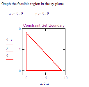

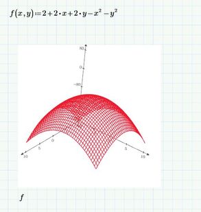

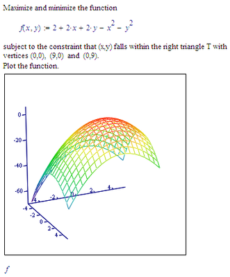

Here's an example (of a former Mathcad), that you should be able to build in Prime to gain experience, and then you should know what to do to rebuild your system for optimization:
Now comes the solve block:
