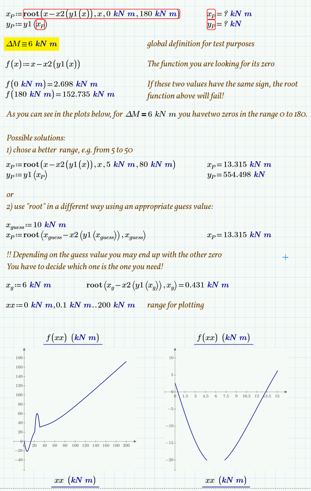

I get an error in the root function when a variable exceeds a specific number. See attached file.

I could open the sheet you posted here and now I found the offending position.
Looking closer at the function you are looking for its zeros and plotting it sure helps!
Maybe this is of help to you:

When you use root as root(f(x),x,x1,x2), then f(x1) and f(x2) must have different sign. This is obviously not the case in your file.
So either change x1 and/or x2 accordingly, or use the root function with a guess value.
First define a (more or less accurate) guess value like x:=2 and then try root(f(x),x) = ...
The calculation may be sensitive wrt the guess value.

if I open Error - Function values.mcdx in Prime 9.0 and run Calculate from Calculation tab then your error appears immediately. From my layman's point of view, there are errors in the file that you have to fix.
