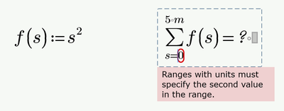

I have a range of lengths. I need to sum them after pushing them through a function. Unfortunately the sum operator is not happy and stating: "Ranges with units must specify the second value in the range". Thank you for your time and help.mathCADSumPost.PNG

@EP_10048426 wrote:
I have a range of lengths. I need to sum them after pushing them through a function. Unfortunately the sum operator is not happy and stating: "Ranges with units must specify the second value in the range". Thank you for your time and help.]
What this normally means is that the user has defined a range with units, but only specified the first and last values, eg, i:=1 m..10 m.
Mathcad requires ranges with units to have the 'step' value, eg, i:=1 m, 2 m .. 10 m.
However, as noted in other messages, it is difficult (read 'normally impossible') to diagnose an error without the guilty worksheet.  Error messages can be misleading or complete red herrings.

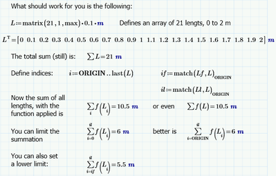

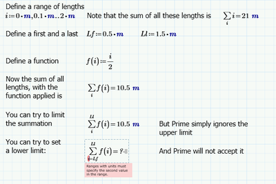

First off: Yes the worksheet is needed! (You should ALWAYS attach the worksheet, or a minimised version, that shows your problem).
Assuming you have i defined as a range with units, this is Prime behaviour:

I don't think that the OP has defined a range variable above the expression shown in the pic. It looks to me that the problem is rather that the upper limit of his sum is not a simple scalar but a quantity with a unit, maybe a length. So basically he is trying to do something like

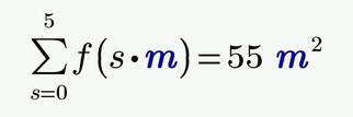

Unfortunately I wasn't able to get the desired result using the sum operator alone without having to define something else like a vector or a a global range variable on worksheet level 😞
OK, one way to avoid defining anything else is to get rid of the units in the summation and add them to the function argument, but I would not recommend doing so:
