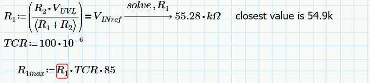

So I'm working with a trial account while practicing with this software for a new job. I've tried to set up a simple algebraic equation, and set the solution to that equation to a variable, in which you can see here:Capture.PNG
I believe that I set the equation up correctly, however I'm getting this error telling me that R1 is not set up as a variable, despite me defining it with the solve above. What did I do wrong?

I guess you ran into an infamous Prime bug which occurs quite often when using symbolics - autolabelling!
Make sure that all variables, especially R1, are labelled the same (either all "Variable" or all "-" which means automatic).
It may also help if you turn on the option "Units/Constants in symbolics" in the calculation options.
But of course we can't be sure as of the cause of the error message without seeing the sheet ...

So I went to actually remake the entire sheet as a sanity check, still had the problem. I swapped on that option, and problem resolved itself. I now have new other interesting bugs (I think) that I need to contend with, but this, which I think was my biggest blocker has been resolved. Really loving this software so far!
