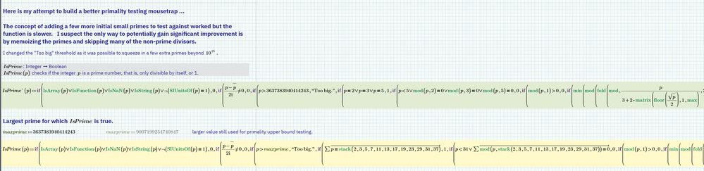

This is what I've been working on over the past few week. Needless to say, all IsSomething functions work (if they work.... see the functions response on a range argument) in Prime express (v4 file attached). Thanks for the IsNested, Stuart!
I'm quite fond of IsPrime, and a native IsRange is dearly missed.
Apologies for not responding sooner, Luc.   I've stolen your IsPrime function for my soon-to-be-reissued Expression Type Functions worksheet.  Very neat.  I thought I might have been able to speed it up a few clock cycles by seeding it with the primes up to 37, but it actually slowed it down.
I did manage to squeeze a couple more primes out of the top end, though.

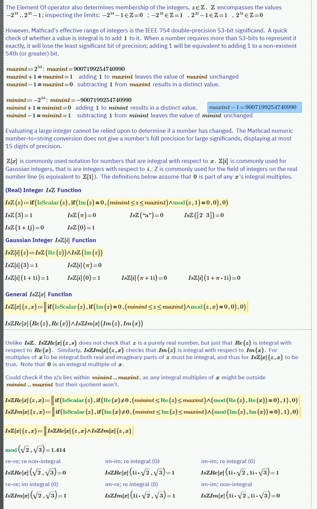

I deliberately limited the top end of the Primes, because the correct representation of genuine integers in the floating point implementation has an upper limit.
Indeed it is through collaboration that we gain more than the sum of the parts.  It’s one reason I liked the Mathsoft forum's name - the Collaboratory.
As with most IEEE 64-bit double floating-point systems, the maximum safe integer value is 253 or 253-1.   I've used this value since Mathcad 11 days.  However, the numerical evaluation of this number isn't necessarily accurate.  As you say, there appears to be a number of digits problem.   I checked it again recently, as I decided to take a take a fresh look at Gaussian integers and other integral number systems.
maxint and maxint-1 do not equate to each other, but they evaluate the same.
In addition, Mathcad seems to think anything outside the range -231..231-1 isn't a member of the set of integers.

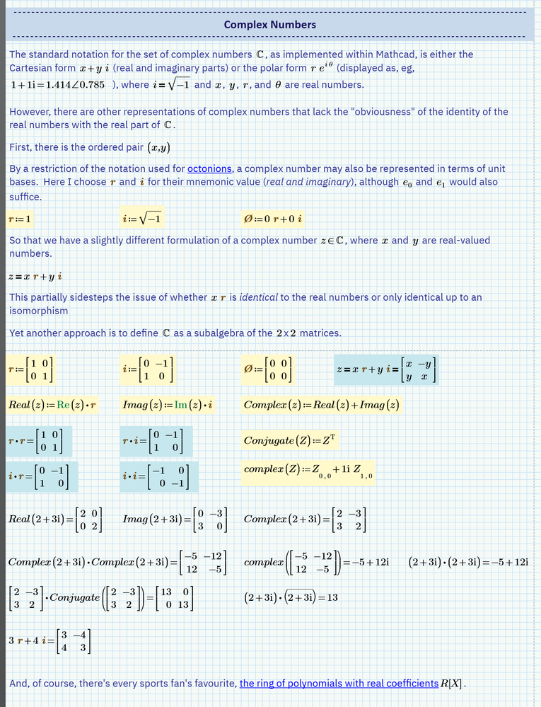

Oh, if one wishes to keep oneself entertained there are many different definitions of what complex numbers are.   Not all of them implicitly regard real numbers as being identical to the real part of complex numbers, albeit that is how they are usually interpreted (particularly as complex numbers are a extension of the reals).
I haven't seen the second interpretation in print, but it makes more sense to me than adding the imaginary part whilst assuming (or defining) the real part to be the real number line.   I also find the very recursive nature of defining real numbers in terms of themselves raises some misgivings on my part (and I certainly don't have a problem with recursion!).
So, back to your questions.  Yes, IsImag is meant to test for purely imaginary numbers - they do not behave the same as purely real numbers.  IsComplex was a means of identifying complex numbers so that I'd know how to deal with them on specific occasions; ranges, for example, can be real but not complex (although I see no a priori reason why they shouldn't be).  Neither IsImag nor IsReal alone is sufficient unto the task; zero is right at the intersection of the real and imaginary parts, hence its inclusion in IsComplex.  Furthermore, reals would possess no additive identity if zero was not a real number, nor would the reals possess additive inverses.
However, part of the reason for posting such worksheets is to garner the opinions of others, not to enforce my viewpoint, and I'm perfectly willing to change my mind if threatened or bribed sufficiently.
Stuart
