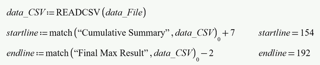

As a workaround and to avoid having to write a parser using the data extracted by READBIN you can detect the correct line numbers via READCSV and the use READFILE as you did.
I replaced the underlines in your data file by spaces and it works OK:
This should work as long as there are no commas in your data file.

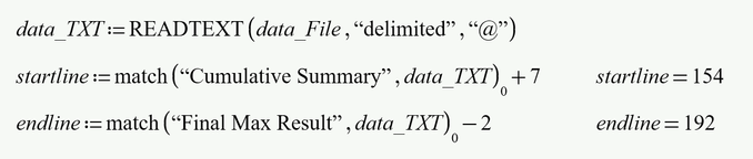

Another option is to use READTEXT with a delimiter character which sure does not occur in the file (I used @)

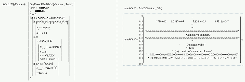

It may also be possible to read in the file using READBIN and write a parser in Prime to exctract the desired data.

Thanks Werner,
I often use a lot of text file input to Prime.  I have a small C++ program that deletes blank lines so I can use READTEXT.
Using READCSV first is a better technique thank you.

We can also use READBIN and split at CR(LF) = 13(10).
But doing so we will also respect leading spaces. Sometimes this can be desirable, but sometimes (as in this thread) it can be bothersome.
So searching for correct line number here would require to use a different search strategy, or to provide the correct number of leading spaces in the search string or to modify READLN so that leading (and maybe also trailing) spaces are skipped.
