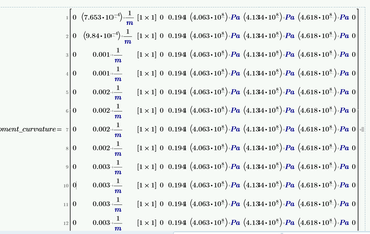

I implemented a step-by-step algorithm with nested FOR loops, conditional checks, and accumulation of results into a matrix Moment_curvature.
Problem description
I expect to obtain a matrix with multiple rows (i.e., 10 rows), where each row corresponds to the final iteration of strains (εc1, εc2), which have to iterate until the condition of equation (4.3) N<0 is true, and contains:
However, Mathcad returns an empty table only, even though:

You have the assignments to Moment_curvature[i,1 through [i,9 outside of the for loop that iterates over i. So at that point i is a constant. Only the last row of the Moment_curvature matrix gets filled. See here:
I guess you must move the assignments upwards in the algorithm, probably at the end of the For loop.
@LucMeekes Thanks for the quick reply. I'll look through the routine, but the question is: whether the assignment should be moved into the FOR loop (where i decrements), and how to "explain" to the code that I need to go further through all the epsilon_c1 increments.
As you see, it is better than the previous look, but all the data is fixed without incrementing.

You state further down the sheet that you expect a 10-line matrix.
Your index i runs over 20, but you have another for loop where m runs up to 10.
Maybe you need to store the data from within that for loop, using m instead of i...?

@LucMeekes I have fixed the proposed remarks... and now I can see the error place
But it still doesn't work as it should.
