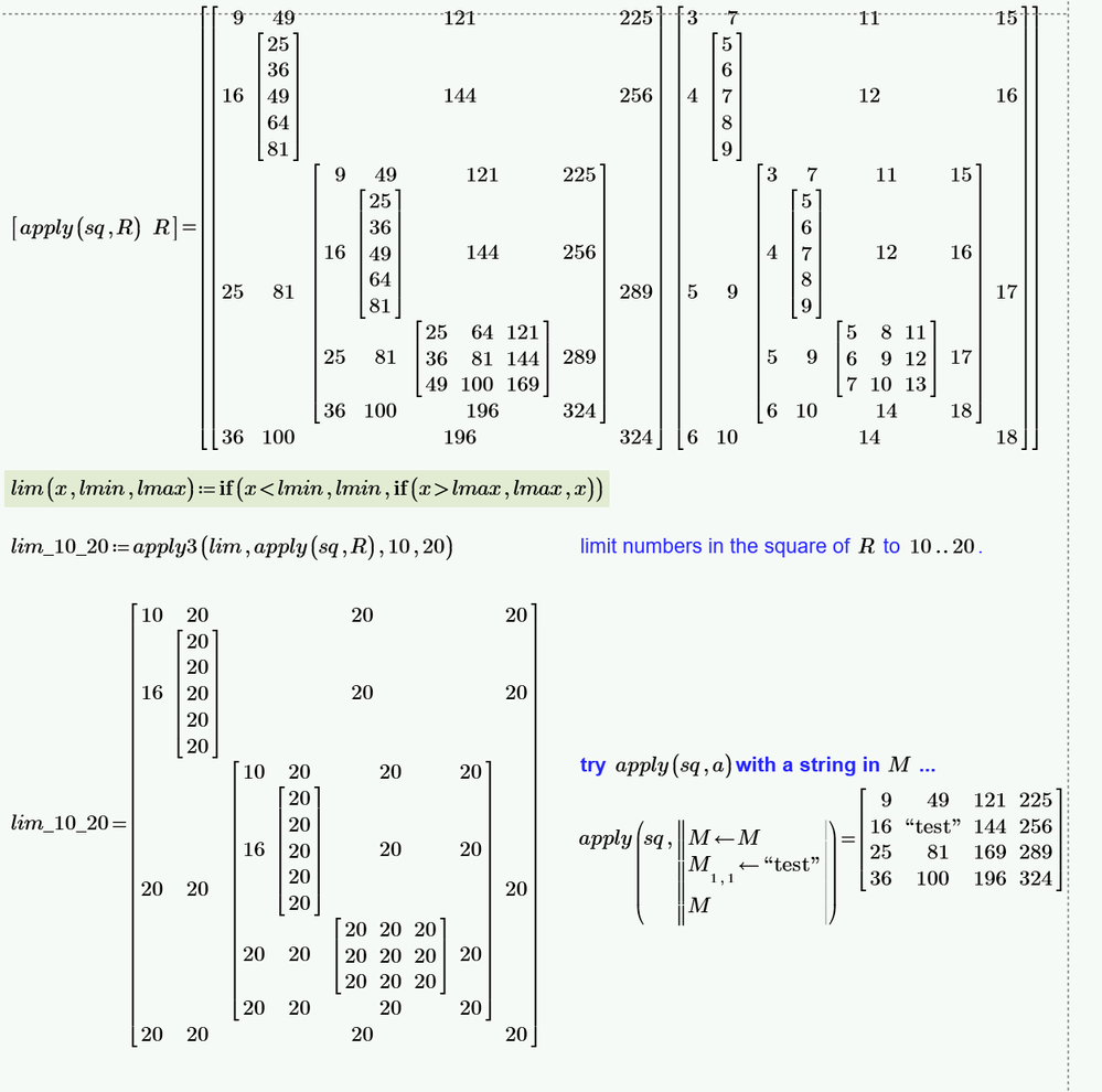

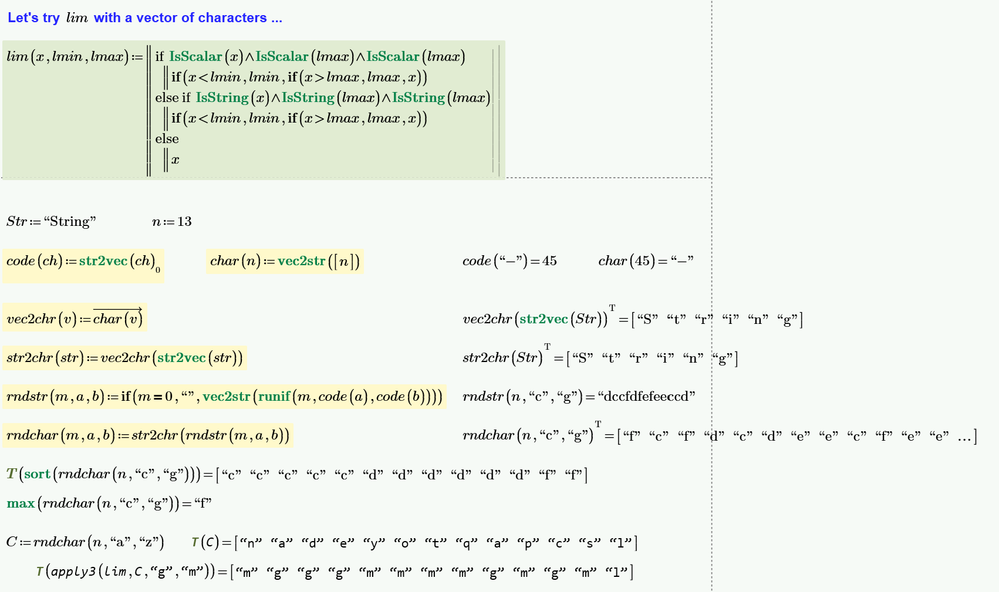

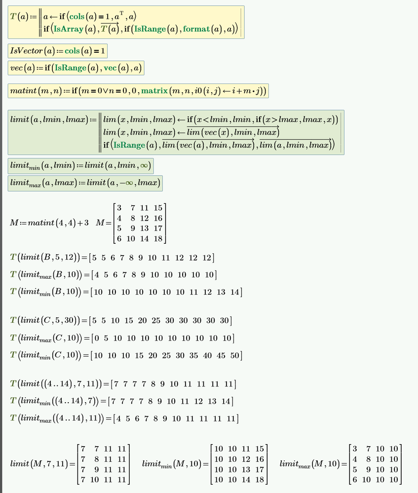

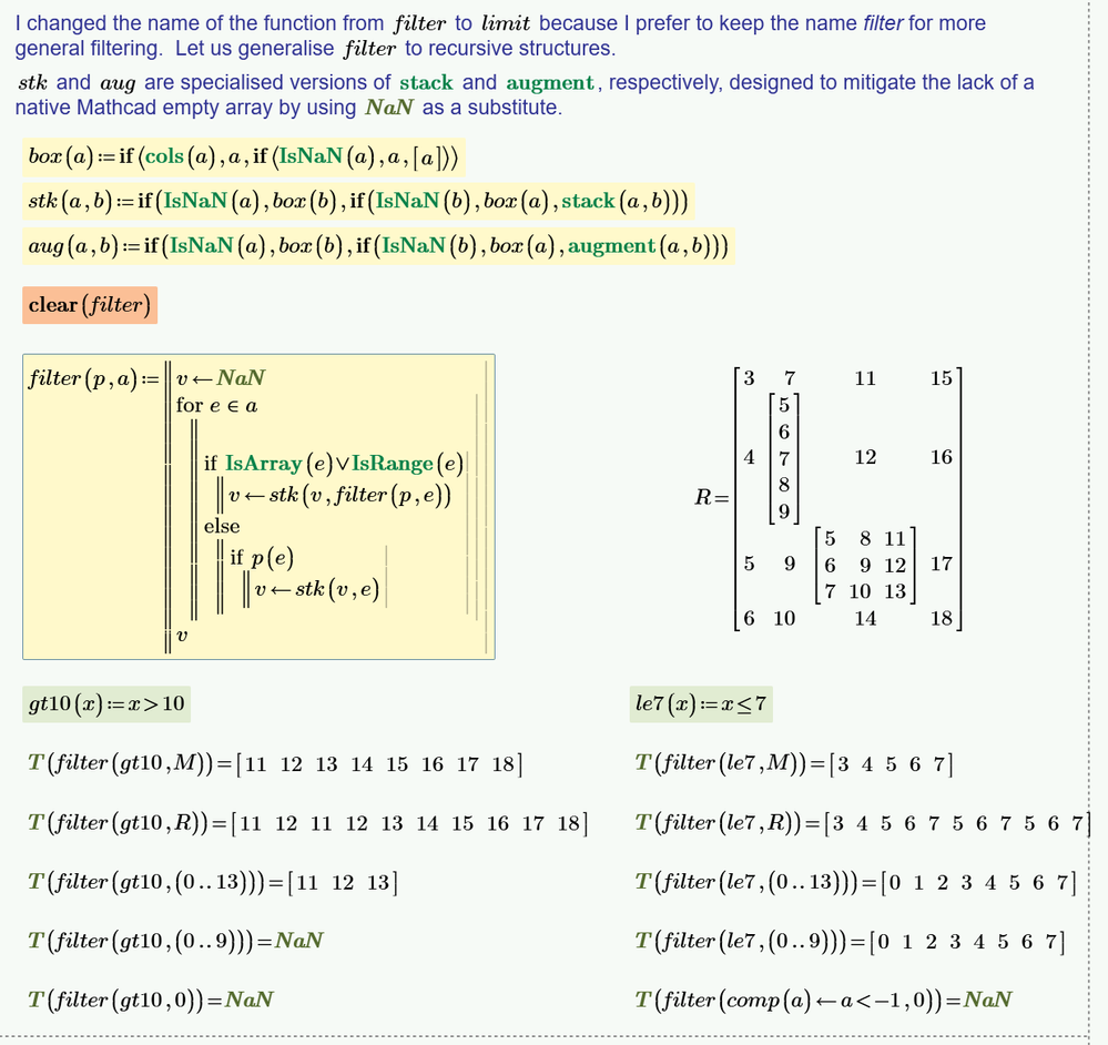

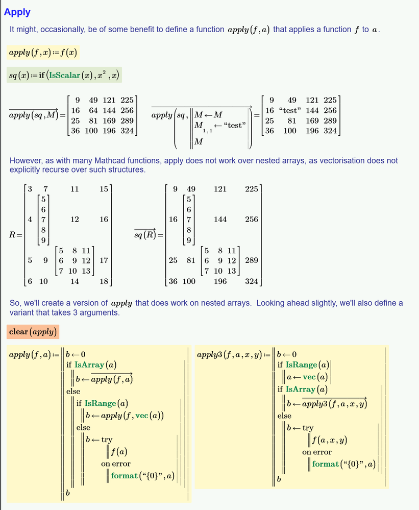

Whilst searching for something else in the Community, I noticed this thread and ... well, I couldn't help it, I just had to play with your worksheet.  I only intended to write the first limit function and bring the thread up to Mathcad Prime 11 state, but one thing led to another, und so weiter ...

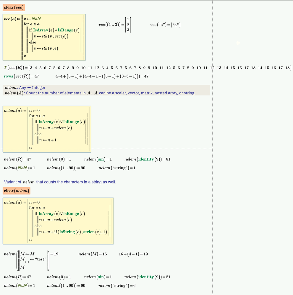

Recursive vec rewritten to use stk.  I've found nelem useful for doing quick checks on nested array function outputs.
