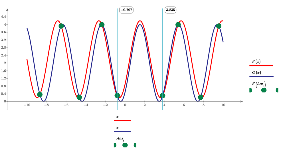

Hey, I need a littel help with this:
I have been given two functions
and I need to find the two intersections in the interval -1<x<4.
How can I do this?
Thanks alot!

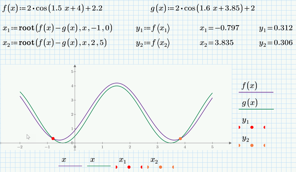

(To:GC_9773915)
Here is one way, using the numeric "root" function
File format: Prime 9
4 REPLIES 4
(To:GC_9773915)
