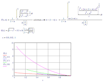

Please see the attached file. Help needed to do a function of a function and plot the graph.
Help will be appreciated.

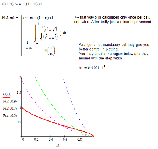

Something along these lines?

April 23, 2020
Press F9 after opening the sheet. It doesn't calculate automatically.
In addition, for speeding up, you may want to set TOL:=0.001 at the top of the sheet.
And you can have the range of x as x:=0.001,0.002...1
The x or x1 doesn't matter. They're just parameters.

April 24, 2020
April 23, 2020
Here are my 2 cents:
MC15 worksheet attached.
BTW, I guess Lucs worksheet will work OK, if you turn on auto-calculation. Luc has it usually turned off and so you have to manually recalculate (Ctrl-F9) after every change.

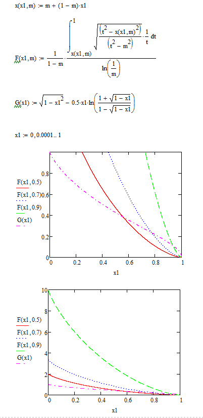

April 23, 2020
Here is another way to deal with those nested functions:
