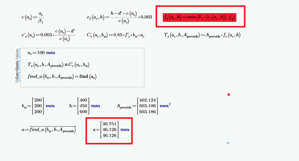

Dear Everyone,
How can I solve the root of equation as matrix as picture attachment (Red Circle)?
Many thank for replying

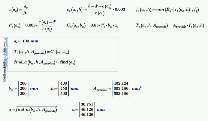

Set up the calculation just for single values, turn them into functions and call them vectorized.
Maybe that way:
Maybe that way:

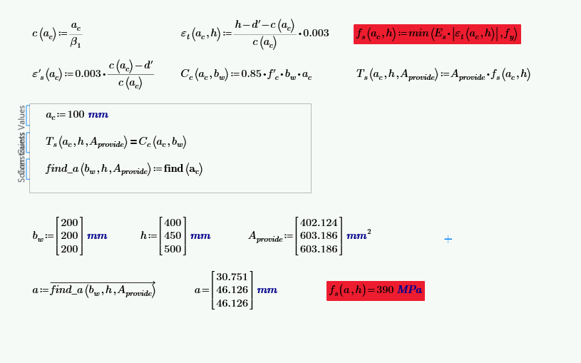

fs(a,h) it should be matrics but it isn't. I just know that because min()  make the solution wrong. I can't solve it.
Please solve it ,
Thank you so much!
You have to use vectorization:

 It still wrong because min(Es*|et(a,h|,fy)  (Red Highlight) the result not matric but number that make the answer of fs(a,h)  wrong and cause a  (the element of number in [] should be different because it depend on h )  wrong too.
The solution that I want to find is to make min(Es*|et(a,h|,fy)  to Matric to take its element to take part in Calculation.
|et(a,h|   its result is Norm of Whole matrics  but not Abs of Element of Matrics. We need it as Abs of Element of Matrics, if we can do, The solution is.PTC3.png
But this is exactly what happens when you call the function vectorized!
