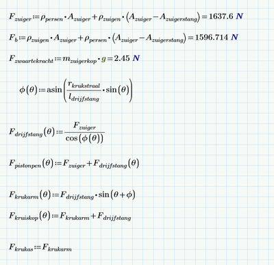

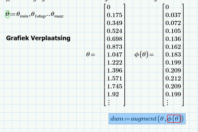

So for my industrial desing  class i have to calculate the force on a crankshaft.
I made the formula's but i cant seem to get my graph. I think my Phi is not a vector but i dont know how to fix it.  I tried using another word for it  and other things but nothing works. any idea's? thansk a lot

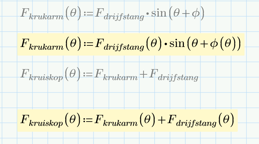

Two of your functions need parameters:
Prime 11.0.1.0 file attached
Thank you so much i overlooked that  fact it works ow im so gratefull!!!!! u made my day
