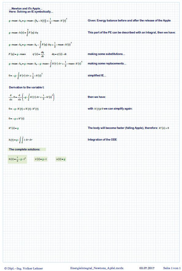

Hi Valery,
If this is the equation for the falling apple, how did you create the IE?
I don't understand it, please explain me.
Thank you, Volker

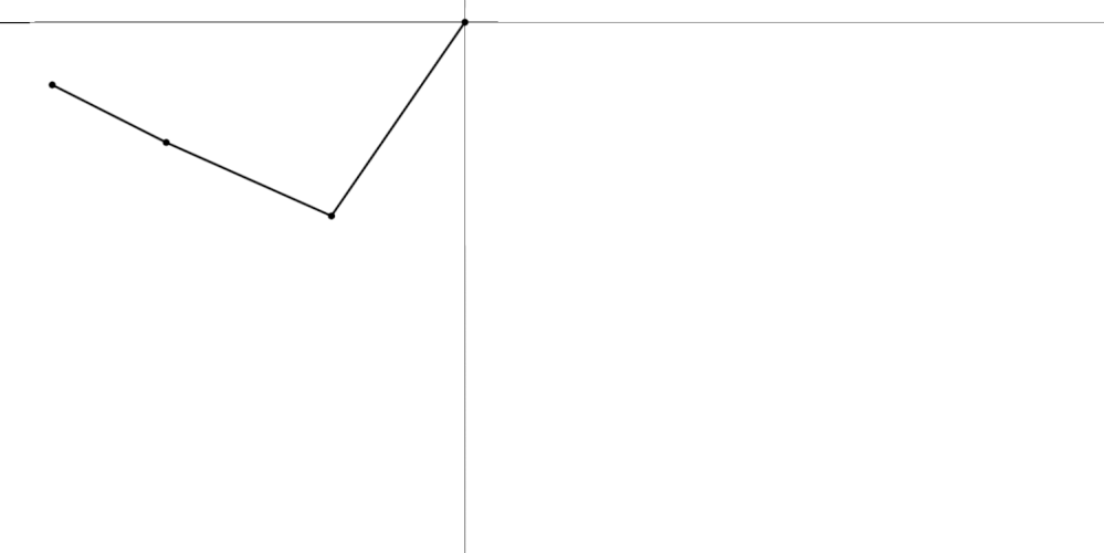

...better to do this one:
Volker

@vlehner wrote:
Hi Valery,
Thank you, Volker
The potential energy of the apple is g*mass*h0 at t=0. No any kynetic energy!
At t>0 we have ane kynetic energy mass*v(t)^2/2 and any potential energy g*mass*h(t).
v(t) is a derivative (производная) of h(t)
h(t) as an antiderivative (первообразная, an integral) of v(t).
Is it OK?
vlehner
(To:ValeryOchkov)
Thanks, now i understand it.
It is in principal that what i supposed to calculate (see my sketch in the above post)
Volker
