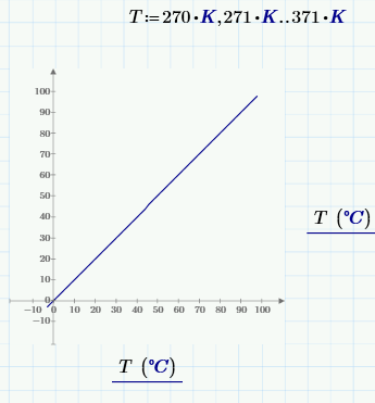

How can I have Celcius not Kelvin on the X-axes of Prime plot
ValeryOchkov
Help please - see the attach
Oviously it does not work the way it should (by simply chosing °C in the unit box) so one crude way is to do the conversion manually. Not very satisfying, I guess.

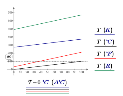

The Kelvin and Rankine scales are absolute--they both start at absolute zero and are therefore a ratio.  Centigrade (Celsius) and Fahrenheit scales have arbitrary (and different) zero reference points.  Mathcad has to use functions for that conversion.  If you look under units the the ribbon, you can select which units to plot with.

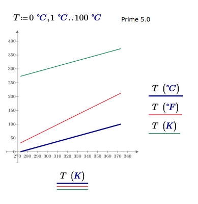

Hi Fred!
Think we found a bug in Prime 5!
What you show was exactly what I tried first (and Valery sure did so, too) and it failed because we both used Prime 5.
It works OK in Prime 4 but throws an error in Prime 5!
So the bug was freshly introduced with Prime 5 (and we thought there would be no development of Prime any more 😉

Valery needs/wants  °C on the abscissa!
ttokoro
(To:Werner_E)
I understand what is the problem. X-axes allows K or R and not degree C or degree F. (x=x*unit ,not x=x*unit+C*unit)
So x axes can use the unit of delta degree C.
But Prime 4 (Expresseven) allows deg C on the x axis as well
