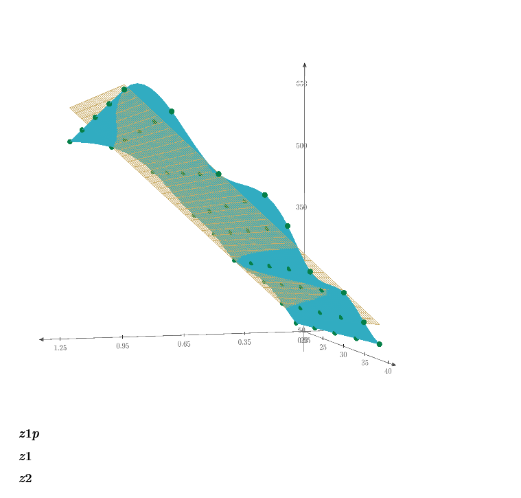

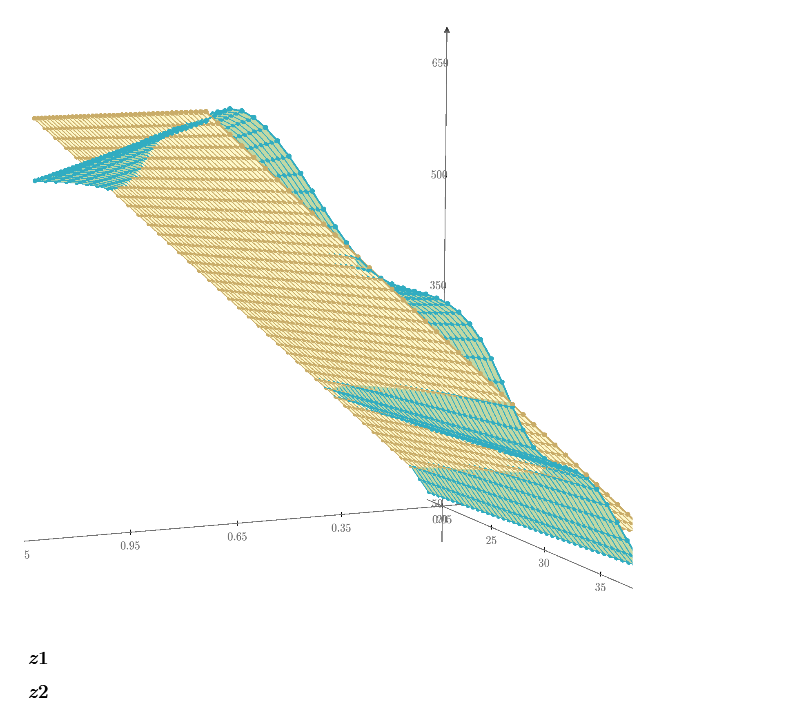

Change the color of points and surface.
Thank You!

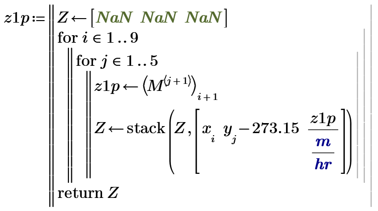

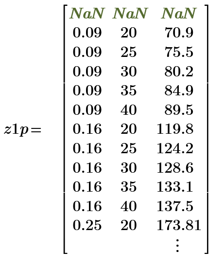

But I need plot not points of grid but points of origin data in the matrix M.

Send please the Mathcad Prime sheet!

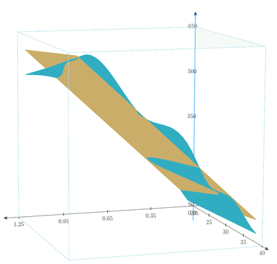

Thaks one more. But I need Prime 6 or tha normal full picture.
I think so
But I need more correct regression formula! Help please. Prime 6 in attach.
