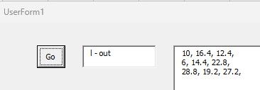

OK lets go from the beginning.
Mathcad needs an output with an alias.  It will also have a count.
matrix is called "here" and it is the second count( 1 as zero based counting).
b is set as an integer with value 1 being the zero based count of outputs.
"hereResult" is defined and set to the output alias "here" the matrix.
The matrix is output
Cheers
Terry
Cheers
Terry
