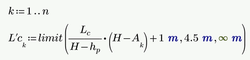

Hi, i don't speak english but
I want to limit the values in an array
MathCad Prime 10
Please help me

I want to set the mín value to 4.5 m

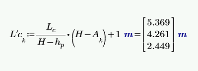

The expression with the values shown in your screenshot can't be seen in the file your attached.

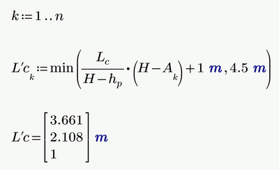

But using the "min" function should effectively limit the values so all values above 4.5 m are set to 4.5 m

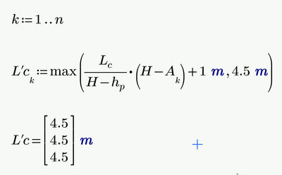

EDIT: Ahh! I just read that you want 4.5 m to be the minimum value. So you should use the "max" function to set all values below 4.5 m to 4.5 m.
As with the values in your sheet all three results are below this threshold, all three are set up to 4.5 m.

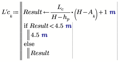

Of course you also could use an if-statement

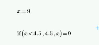

or also the if-function as suggested by ppal
The local variable "Result" was introduced as otherwise it would have been necessary to use the calculation expression twice, which I considered being harder to read and inefficient.
