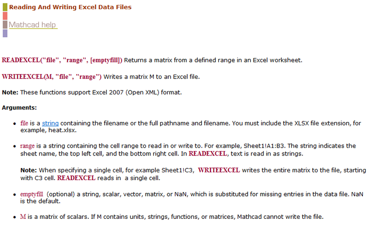

(To:richardm55)
How about the WRITEEXCEL function?
Do you know how to use this function?
(To:richardm55)
I would trust the built.in help documentation
