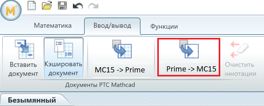

One my student has a little business - the manual converting Prime files to MC15.
Click this button and open a dialog box with e-mail of this student!
Thanks to PTC!
