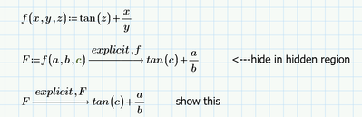

I have a cheat sheet of beam equation, all expressed as functions of variables such as w, P, l, etc. The challenge arises when I apply it to compute load combinations, as the beam equation becomes visually convoluted. A reviewer would only see a series of functions, necessitating them to backtrack through calculations to identify the specific function in use. An alternative is to redefine my input variables (w, P, l, etc.) and directly solve the beam formula without using functions, essentially copying the equation. However, this becomes cumbersome due to the need to clear variables for each subsequent equation. Is there a method to explicitly solve my functions and revert them to the original equation?

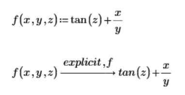

I did not know about the "explicit, ALL" and dummy me did not scroll down on the explicit examples that mathcad gave (https://support.ptc.com/help/mathcad/r8.0/en/index.html#page/PTC_Mathcad_Help/example_explicit_calculation.html when I looked into this earlier.
This is what I was trying to achieve.
Now my next question is how do I stack the equation after the explicit or just organize it so it doesn't spill off the page

You know about the "explicit", "explicit,<variable name>" and "explicit,ALL" modifiers for symbolic evaluation?

So after some tinkering I came up with this. I can put my variable equation into a hidden region. Then restate the explicit result in another region. It's the best I can do to condense the result so a reviewer wouldn't get confused.
