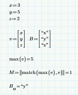

How do I find the name of the variable that has the maximum value in a set of data. For example, if I have x=3, y=5 and z=2. I want to find the variable name for the maximum value. In this case it would be "y".
(To:SD_8739877)
Unfortunately Prime offers no way to access the NAMES of variables.
But if you collect all values in a vector, you cannot only find the maximum value but also the positions, the indices where in the vector this value occurs. Notice that by default the first element has the index 0.

Thank you for your response! I was able to take what you said one step further. I am not worried about repeating numbers. I am just trying show the maximum moment on a beam with different load cases.

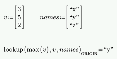

You could also use the lookup() function to do the job.
But nonetheless it is still necessary to define a separate vector with the "names".
