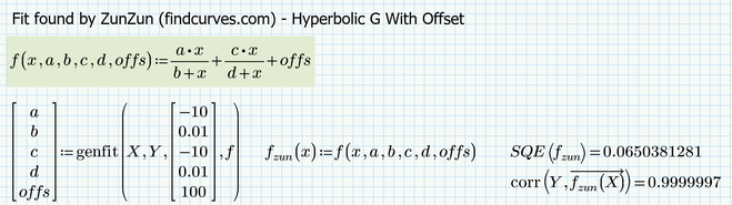

I tried the site suggested by DJf (I knew the site as ZunZun from former times) and it was indeed able to find the best fit so far
I added it to my sheet
With free eyes you hardly can spot a difference to the best so far.
Main difference seems to be at the front values

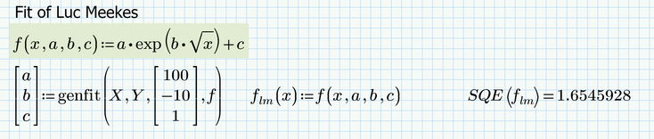

My guess is:
with
So use genfit.

@TC_0928 wrote:
How did you arrive at this formula...
As Luc wrote - he guessed based on his experience that this type of function might give a good fit (and it looks like it actually does).

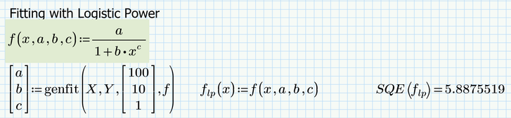

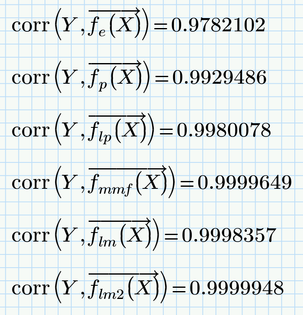

I defined a function which calculates the root of the sum of squared errors so that I have a measure of the quality of the fit (the lower the value, the better the fit).
Exponential and polynomial fits do not provide good approximations
Logistic power was quite better

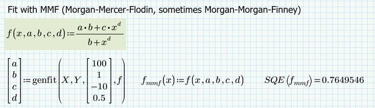

but MMF proved to give the best fit so far
Its even slightly better compared to what Luc had suggested
But when I added that additional parameter (exponent of x) in Luc's suggestion as described above, I got the best fit of all of them (so far)

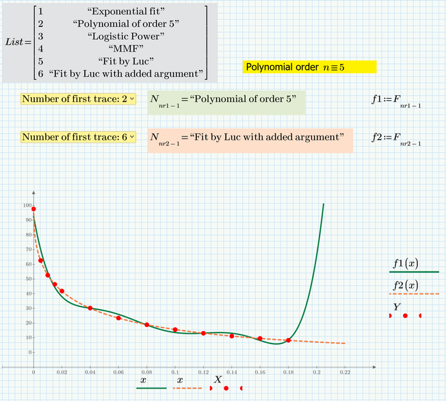

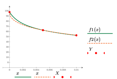

In the attached sheet I added a plot where you can compare your data against two of the six mentioned fit function which you can chose via a combo box. You also can set the order of the polynomial here by changing the global assignment for n.
As an example here the comparison of a fifth order polynomial with the last mentioned fit function:

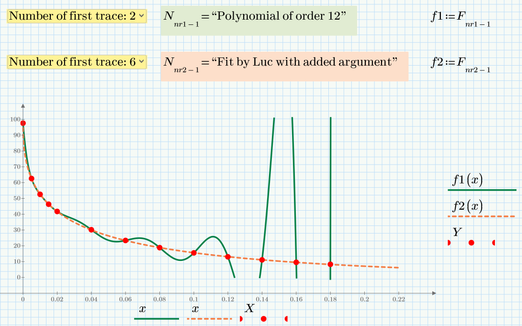

Increasing the order of the polynomial does not really help. You may chose a 12th order polynomial which would run exactly through all your 13 data points and therefore has an SQE value of fantastic zero, but I bet that nonetheless you would not be happy with this fit:
EDIT: Just found a bug in Prime. Changing the order of the polynomial does not always refresh the plot. A manual recalc (F5/F9) of the sheet is necessary so the change also shows in the plot.
EDIT2: You may also use the built-in "corr()" function as a measure of quality - the closer to 1, the better.

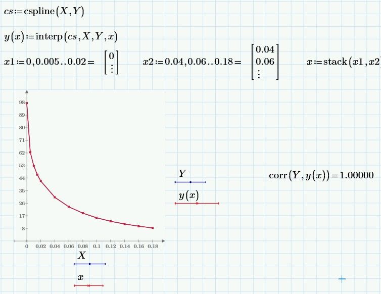

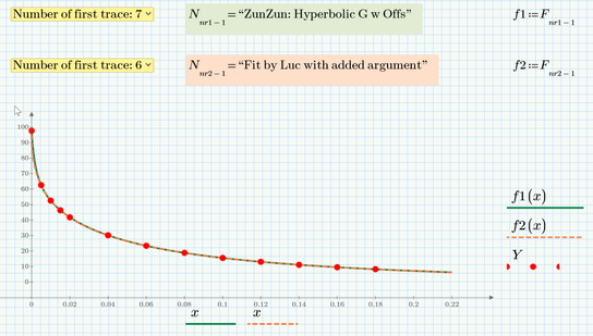

Often overlooked are splines as a means of fitting data with a smooth curve. Is not what you asked for but it works.

But then - EVERY interpolation would yield a perfect correlation of 1, no matter if its a spline interpolation or a simple linear interpolation.
If an interpolation is appropriate as opposed to a functional fit depends on the needs.
