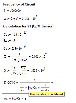

I am doing a calculation of RLC circuit in MathCAD, but I am facing to a problem with usage of "i" ( notation of complex number) as shown bellow:
Please help me to treat this .

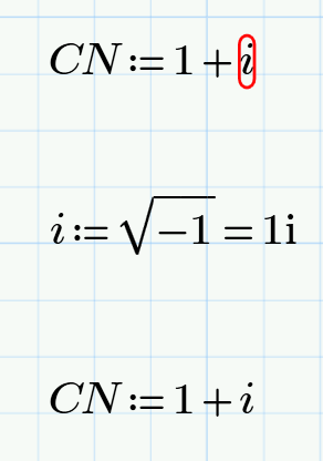

Hi. In Mathcad imaginary unit is 1i or 1j, but shows just i or j.
Best regards.
Alvaro.

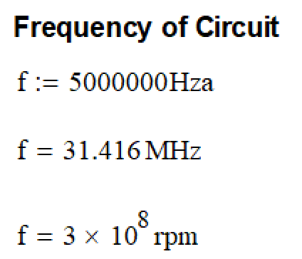

Mathcad Prime - new in complex number formatting
I have seen a lot of Mathcad-sheets with:
See please - with units

Works for me if I define j  as the square root of -1
In real Mathcad (=MC15 and below) I would strongly advise against doing so, but in Prime I have to admit that the imaginary unit displayed as 1j or 1i simply looks too ugly and so I understand that defining j:=1i or something like that makes sense.
